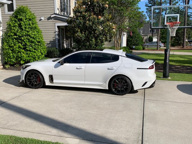

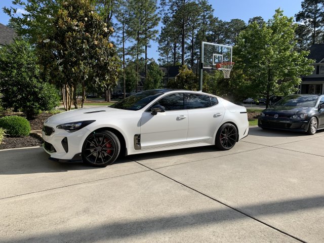

hey guys, got the car dropped on ARK springs and added Vossen HF3 wheels. 19X8.5 front, 19 x 9.5 rear. using oem tires for now, but could go up a size when it's time to replace them. worked with Diego and Jereme at Vossen and bought direct from them. I worked with Diego in the past on a previous car. great guys down there. I lost about 5lbs per wheel on the front and 7 lbs per wheel in the back versus the stock wheel weights. I simply weighed each weel on my home scale so not super scientific but you get the idea. they are far lighter. Wheels are transparent gloss black finish. They fit pretty flush with fender as well. Pics: IMG_0781 (1).jpg IMG_0782.jpg IMG_0783.jpg IMG_0784.jpg IMG_0785.jpg IMG_0786.jpg IMG_0781 (1).jpg IMG_0781 (1).jpg IMG_0782.jpg IMG_0783.jpg IMG_0784.jpg
