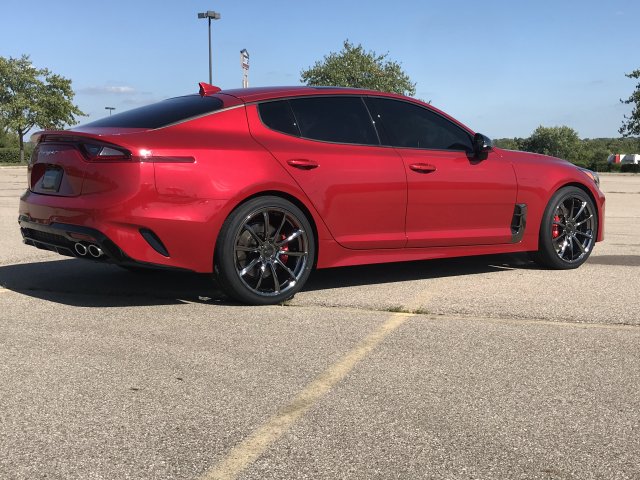

Wheels: TSW Nurburgring in Matte Gunmetal, 18x8, +35mm offset front, 18x9.5 +40mm offset rear, special order gunmetal center caps
Tires: Nitto 555 G2, 245/45/18, 275/40/18
Suspension: stock
The rear comes very close to lining up with the wheel arch, so lowering might be a problem. There's room for a deeper offset, but that's as good as I could order.
Suspension: stock
Suspension: stock

Wheels look great on your car (y), I'm just asking but why did you go with the 18s an not the 19s?
I like rubber! Don't like the ride quality of tires below a 40 series, and prefer this kind of look. I'm an old school muscle car guy, so moving from 14" rims to 18" rims is enough evolution for me. :D
I also think the semi-stretched look of the stock PS4s is awful. And I tore THREE front right tires on potholes around here.
What was the cost of those wheels with the special order color?
The wheels are stock items - generally $308 each. Check the TSW site - they come with these awful bright aluminum centers. My vendor (getyourwheels) charged another $100 for a set of gunmetal centers from a different TSW wheel.
