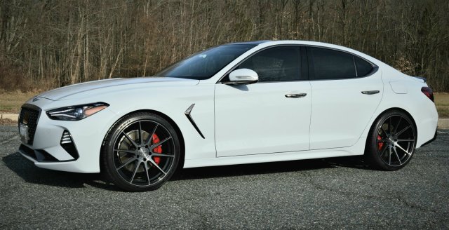

Here's mine:
20x9 +32, 20x10 +40 Vertini RFS 1.3
245/35/20, 275/30/20 Falken FK510 tires
Eibach Prokit for Stinger GT (.8" drop for RWD cars).
Ride is firmer, but handles better. Wheels are lighter than stock 19" sport wheels. Not my daily driver, so only a hundred miles on this setup but so far, no rubbing.
Purchased the wheels and tires from getyourwheels with preprogrammed TPMS. Had one sensor that had to be reprogrammed, but they sent me a programming tool to use and send back. Works flawlessly now.
