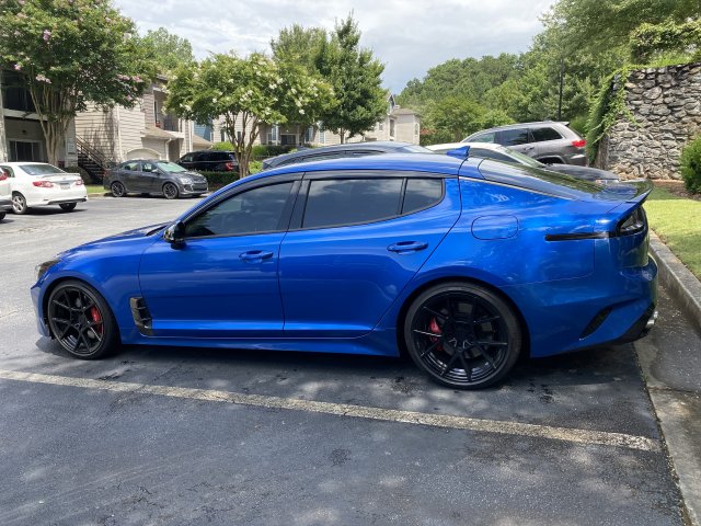

I have the Eibach sways but ended up going with Ark gt-f springs. They work better with oem shock play and drop it just enough (1inch) so no rubbing issues. Comfort level is like stock with improved handling and cornering. Less harshness over bumps. Worth it to me. I need to get new tires with thicker sidewall as I’m wearing out the oems but just to give you an idea of the drop.

Thank you! I was wondering about the Eibach 1.4” drop on the front and rubbing issues. That 1” drop really makes a visual difference…does not look as much like a 4 wheel drive truck :)
When you say new tires with thicker sidewalls…is that due to the springs? Or something else?

Welcome @Blueray car is looking great.

I need to get new tires due to the softness of the OEM tires. I went up in specs to 19x8.5 and 19x10. I also want wider thicker tires with these aftermarket rims for better grip and traction.
